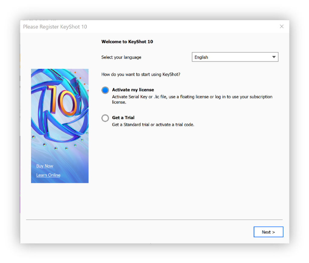

Activating Your License
If you already have a previous version of KeyShot installed, the first thing you will see, when you launch The new version of KeyShot, is the Migration Assistant. This can help you set KeyShot up to match what you are used to as well as transfer your license information, so you do not have to enter it again. Learn more about the Migration Assistant.
First time you launch KeyShot on a new machine, you will be asked if you have a license or if you want to try KeyShot. If you already have a bought KeyShot or have access to a Floating license, select Activate License, otherwise you can select Get a Trial and get a free Trial.
