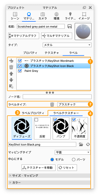

1. Layer List
An unlimited number of labels can be added to a material. Each label can have its own mapping type. If an image has an alpha channel embedded, it will be retained and areas of transparency will not show.
Add Label
Labels are added by clicking the “+” Icon and selecting Add Label (Texture), Add Label (Video) or Add Material. Once added, the label name will be displayed in the list. You can also choose “Duplicate” to create copies of existing labels.
Add Material will simply add a layer of the material selected in Label type (2) on top of your base material, while Add Label (Texture) and Add Label (Video) also will add a texture to the Diffuse map (4).
Delete Label
Labels can be deleted by selecting the label in the list and clicking the Trash Icon

Layer order
Labels will be layered as they are added. If labels overlap on the model, they will stack in the same order as ordered in the Labels list. The label order can be shifted by pressing the up and down arrow buttons.

2. Label Type
Each label will be assigned a material type. The default material applied to a label is plastic, but it can be changed to Diffuse, Flat, Metal, Paint, Translucent, Advanced, Anisotropic, Metallic Paint, Plastic (Transparent), Translucent Medium, Emissive, Toon, Xray, Generic and Plastic.
The Measured materials of the variants axf-SVBRDF and -CPA2 are supported too. axf-Volumetric Measured materials will work, but the opacity map will have no effect.

3. Label Properties
The Properties Tab will show the contextual settings for the label type selected. See the Material Types for more.
4. Label Textures
Map Types
Texture and video Labels will be added as Diffuse maps. In the Label Textures tab you can add other maps to your label similarly to the Textures tab for Materials. The type of texture maps available to a label type will be similar to the type of textures available to the material type.
Use the check-boxes in the list of texture types to enable or disable a texture map.
See the Map Types page for details about Bump, Diffuse, Opacity maps etc.
